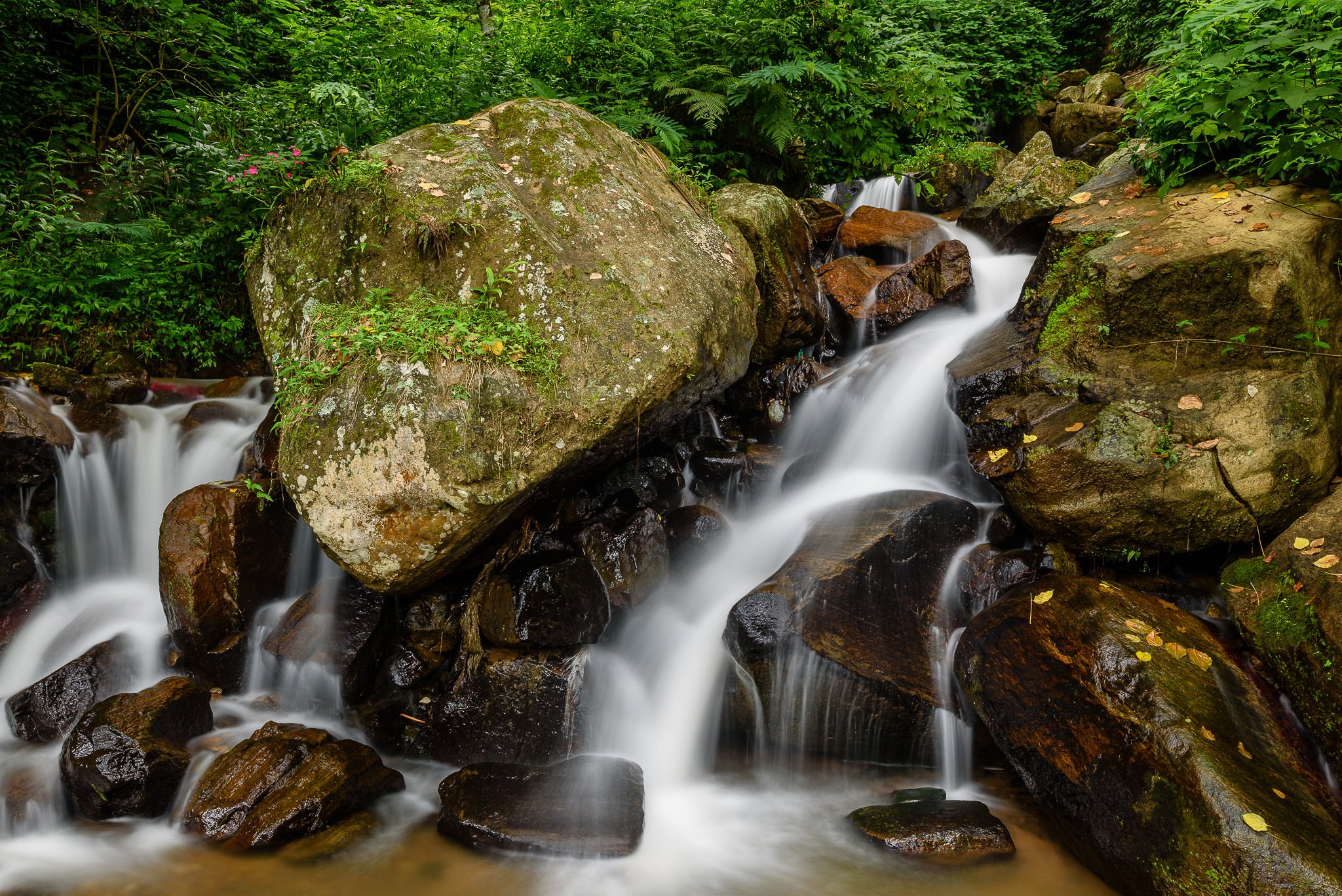

And this is just one sample image. I could showcase hundreds of images, which would not have been possible without a polarizing filter. For example, when photographing waterfalls, a polarizing filter is an indispensable tool. I would love to see someone recreate the following photograph without a polarizing filter:
When photographing waterfalls, you deal with highly reflective rocks, since they have water and other wet vegetation on them, all of which send nasty reflections right into your camera. A polarizing filter makes a huge difference in such situations, not only significantly cutting down on those reflections, but also increasing the overall saturation and contrast of the image.
In short, it is impossible to simulate the effect of a polarizing filter using software!

For the earlier image of the waterfall, I had to decrease my ISO to 50 with the polarizing filter, which gave me a shutter speed of 5 seconds. If I wanted to increase the exposure duration even further for long exposure photography, my only option would be to use an ND filter.
