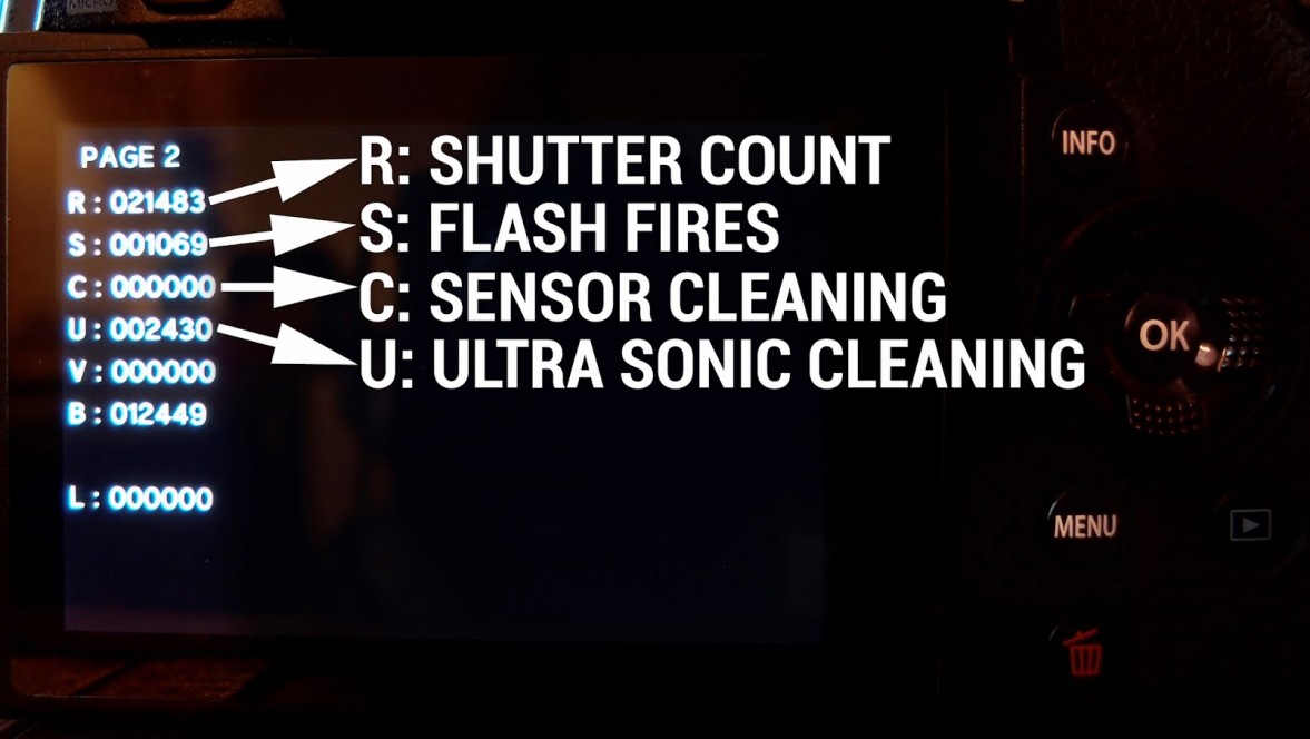

  12. Press arrow pad UP (a PAGE 1 with some abbreviations and numbers appears);
  13. Press arrow pad RIGHT to move to PAGE 2;
  14. Write down the number to the right of "R" on PAGE 2. This is the number of shutter releases (the number to the right of "S" is the number of times the flash has fired);

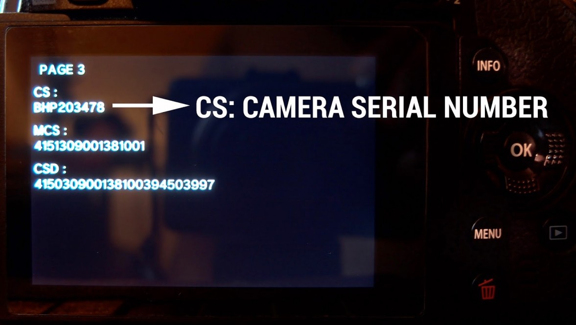

At step 12/13, you can use the arrow pad buttons to move between several pages of hidden menus. The listed information is mainly intended for Olympus service personnel and helps them diagnose any problem that the camera might have experienced. In case you are interested, Olympus expert John Foster has deciphered many of the codes and reports them on his biofos.com site.

화면에 표시된 숫자의 의미입니다.
참고로 E-M1 Mark II에서는 R이 아니라 MS(Mechanical Shutter)로 표시됩니다.E-M1 Mark II부터는 전자 셔터는 셔터 카운트에 포함되지 않습니다.

==> PAGE 1이 뜬 상태에서 십자키 오른쪽을 누르면 PAGE 2가 나옴
PAGE 2에서 R이 셔터 카운트1등 1P
